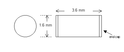

SMD - Melf Dioden SOD80
sod-80 package diagram
