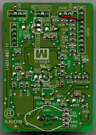

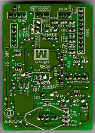

    "Beforer and after"
    To get Vsync to the 13W3 connector, remove the small PCB at the lower
    right backside of the monitor. (the same PCB that holds the mini-DIN
    connector at the back), and solder a small wire from CN252 to CN254,
    as shown above (leftmost pin of CN254 and 3:rd from the top of CN252
    in the pictures).
    In case your monitor came with no connector attached, all 10 non-coax
    pins from the male 13W3 that should have been atthed end of the cable,
    terminates in CN252 on the same little PCB.
    The three coaxes should be easy to identify, one red, green and blue
    (my green was brown).
    Numbered down-up, CN252 is connected to 13W3 like:
    CN252	 13W3  color (in my monitor)
     1	  1    brown
     2	  8    black
     3	  6    yellow
     4	  9    green
     5	  2    red
     6	  4    orange
     7	  3    blue
     8	  7    purple
     9	  5    white
    10	 10    grey
    So if everything is clear so far, you should have soldered to the
    third pin from the top of CN252, pin number 8 (purple), and that is
    pin 7 in the 13W3, v-sync.
